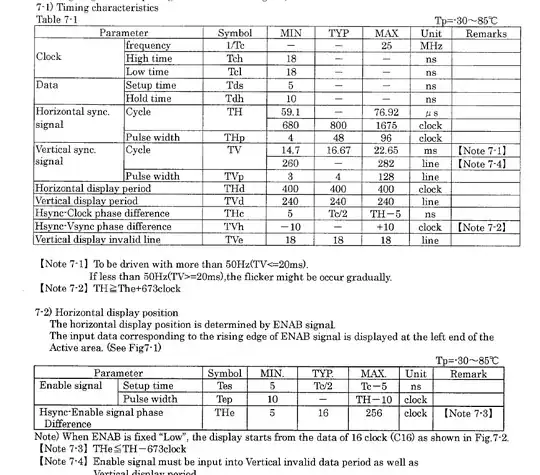

Timings are here (taken from PDF) :
timings
My question is will I be able to create proper HDMI timing config for this LCD screen and have the converter display picture through LVDS correctly in 400x240 screen ?
