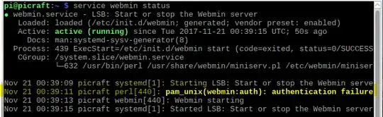

So, basically, after experimenting with making my Raspberry Pi a Minecraft server. I've thought about it and I also discovered I have a 1TB external USB hard-drive, and so I now I want to turn my RB-Pi into a file server so that way I no longer have to bring my hard drive with me. So I followed guides like this and it took me a while to realize that once I depackaged Webmin I could immediately go to my private IP and configure/access my personal file server.
The trouble is, before-hand I tried using this guide first. Installing Apache, and then when I connected it brought me to Apache's page. So thinking that these programs were conflicting I uninstall Apache - reboot my RB-Pi - connect again and still nothing. I even used the right port 10000. There was a sign that it was working because it took time for the page to load to show nothing. Whereas if both services are stopped it just immediately says "Failed to connect."
Ignoring all these details, I go check the service of Webmin and it gives me this message.enter image description here
Now I check perl's status:enter image description here
I even tried uninstalling and reinstalling the perl service. I do remember installing this service before with other projects.
So with all that information. Is there any way to fix this?

Perl is a programming language and associated interpreter. Webmin happens to be written in perl. The authentication error probably has to do with your file permissions when you setup webmin
It's probably a good idea to stick with owncloud which is far simpler to setup and use. webmin is probably not the application for your use case.
