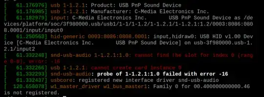

My microphone shows up as a USB device when I run lsusb but doesn't show up when I try a arecord -l
I have attached a copy of the dmesg log which shows an error. Any suggestions on fixing this issue are welcome.
Screen shot
