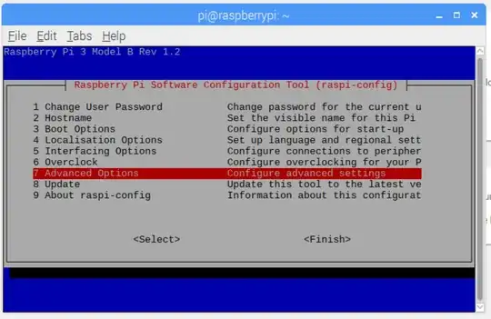

Assuming your running the latest Raspbian Stretch with Desktop.
To enable OpenGL, from a terminal window:
sudo raspi-config

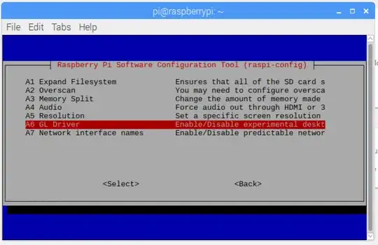

Select 'Advanced Options'
Select 'GL Driver'

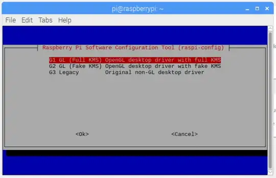

Select 'GL (Full KMS)'
Then Reboot
