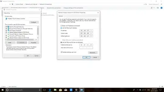

Try this.... Watch the video first(Given in the link) Click here to know how to setup static ip for RasPi And set static ip for your PC's Ethernet adapter and Check that your WiFi adapter shares internet. Static IP for ethernet WiFi internet sharing
