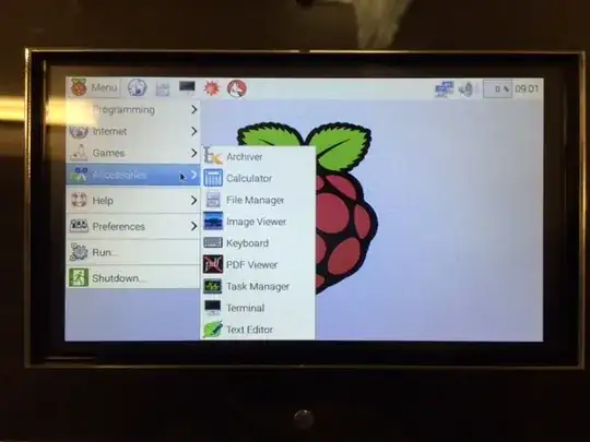

Now you can access the keyboard:
MENU >> ACCESSORIES >> KEYBOARD
Access the keyboard
(source: modmypi.com)

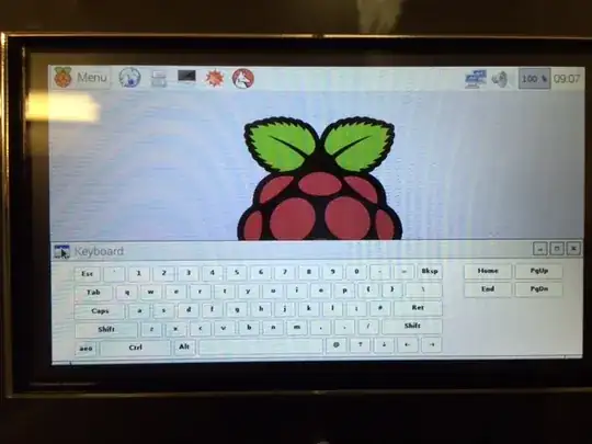

If everything has gone perfectly you will now have an onscreen keyboard.
Onscreen keyboard
