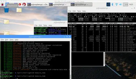

I am running my raspberry pi 3 with a radio station software PiFmRds The program works fine but then when I go to move the window (or any other window) the system freezes and I have to unplug and replug my pi in.
Where can I find the appropriate error log to narrow down the problem?
I have a webserver on the same pi and after it freezes it is still serving my web pages (I have checked the cache)
If it helps, I use VNC
My pi working BEFORE i move a window
