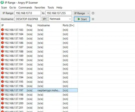

I have Raspberry PI model 3. I am using VNC to access the Pi over Ethernet.
Everything was working perfectly fine, until one time I scanned for alive host using Angry IP scanner. It shows the the IP of my Pi, and that it is dead. Therefore, I can not connect to the PI
I am using windows 10 and just want the Raspberry Pi to be an alive host.

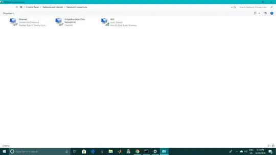

For others who are still stuck: Try doing this: Step1: Go to your wifi and then open Network and internet settings. enter image description here
Step2: After that go to change adapter options.(You can directly search for this after opening the control panel as well, I am just speaking about the way I used to proceed). enter image description here
Step 3: Open WiFi and then click on properties. Step 4: There you will find two tabs one networking and sharing, go to sharing and chances are either: i. sharing is marked (i.e. the bridge between ethernet and WiFi already exists) or ii. it's unmarked. If it's case ii. select the ethernet port to connect to and mark it as allow sharing of networks. save this setting and you are good to go.
If its case i. unmark the option allow sharing save the settings and again open the same wifi tab and perform the above steps and continue as mentioned for case ii. This happens when you leave your pi and keep the bridge unoperated for long go. The way in which I explained kinda refreshes and re-establishes the connection between the pi and the system. Happy rasping!

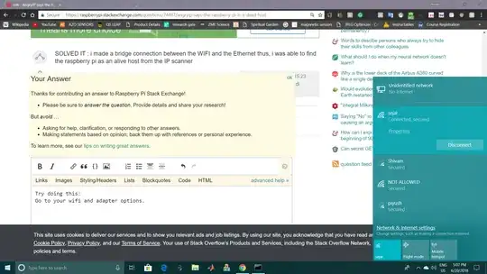

SOLVED IT : i made a bridge connection between the WIFI and the Ethernet thus, i was able to find the raspberry pi as an alive host from the IP scanner
