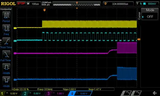

Further measurements and comparison with audio recording show:
  • IF the audible glitch/pop/crack occurs at the beginning of playback (I2S starting), it is visible on both speaker outputs as a positive spike
  • I suspect it could by caused by the LRCLK starting approx. 500 us after BCLK
  • datasheet shows different order in "TURN-ON RESPONSE (STANDBY MODE)"
So back to the I2S interface and driver
Building and running (warning: stopping the program even via desetup_io() does not stop the I2S) ...
~ $ git clone https://github.com/arisena-com/rpi_src
~/rpi_src/apps/i2s_test/src $ make
~/rpi_src/apps/i2s_test/src $ sudo ./i2s_test -t 2
starts the LRCLK on the third rising edge of BCLK and results in a nice ramp-up as shown in the datasheet, although BLCK starts first.
With i2s_test. Clock (yellow) starts two pulses before LRCLK (cyan). Audio out ramp-up visible on both channels (no pop or crackle): good

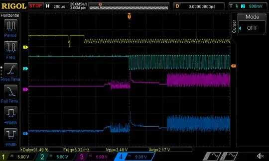

Playing audio. Note glitch/ gap in clock (yellow, about 30 us clock followed by 150 us high). Output (pink/blue) seems undefined before pop occurs (at trigger) when LRCLK starts, about 30 ms before data starts (not shown): bad
Sometimes the pop isn't noticable, but the trace looks very similar.
So is it the BLCK glitch (what causes this, it's probably not intentional) or polarity (i2s_test starts from low-level) while regular operation has high-level?

  • The MAX98357 does not handle the RPi's I2S output well which causes pops/cracks
    • root cause is a short high-level interruption of BCLK before LRCLK starts (oscillograms: actual, generated)
    • unclear if cause is I2S driver or SoC peripheral
    • unclear if other SoCs than BCM2835 (Raspberry Pi 1 A, B, B+, Compute Module, Zero) are affected (please leave a comment)
