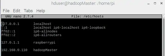

I tried also to put the static IP cofiguration inside /etc/dhcpcd.conf and I am getting the same above error when I try to open ssh connection.
I also added a host name and IP to /etc/hosts , which is not mentioned in the tutorial, but nothing worked.

There shouldn't be a colon : after gateway. Apart from that, you might be bothered by case sensitivity. You're connecting to hadoopmaster, but specified hadoopMaster.
