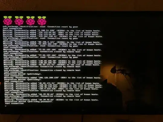

The thing is that today I wanted to SSH my Pi, and when I introduced the password I got "SSH: Permission denied, please try again" together with sometimes "Permission denied (publickey password). Hell, I have not changed the password! Anyway, I booted to single user mode and changed the password. When I totally relieved tried to log in again....damn! I got the same message!

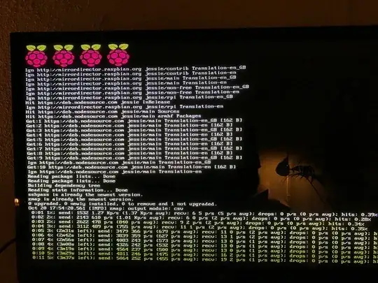

When I then boot the RPi normally, I see how, in the process, inmediately after stating:
zmap is already the newest version.
0 upgraded, 0 newly installed, 0 to remove 1 not upgraded-
The following never ending process starts:
Oct 20 17:54:20.561 [INFO] zmap: output module: csv
But the process gets interrupted by telling me that some hosts have permanently been added? Is my little computer being hacked?
Then the process starts over and over, sometimes reaching 100%, but even though starting again. I even get a message from some NCDev/PLUR stating:

Before I format and reebot my RPi I wanted to ask you guys, if there's anyone that knows what is going on here.
Ivy
  • 29
What was going on is that I was being hacked: http://www.zdnet.com/article/linux-malware-enslaves-raspberry-pi-to-mine-cryptocurrency/
Never keep your default password!
