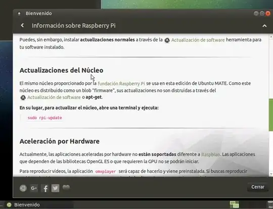

Finally found on the GUI: Welcome --> Info about RaspBerry Pi : the core must, indeed, be updated using rpi-update instead of apt-get.
Here is a capture (sorry, my Ubuntu is in spanish, but I think the sense is understood):
Ubuntu Mate v16 recommending rpi-update

While Ubuntu MATE once recommended this, they have since provided kernel and firmware updates in the same way as Raspbian, following testing of the complete package.
