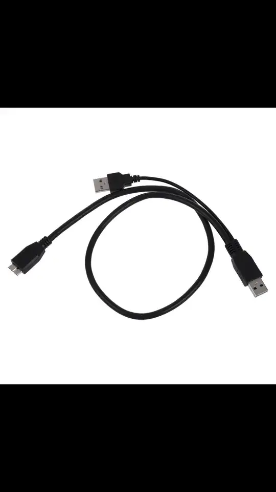

Use a Y-type USB cable
foo
Power one male jack from a 3A power supply, another goes into the Pi. Expect 1-1.5A per drive to operate without problems. If you can’t readily or cheaply get such a high current supply for 5V, get a nice buck converter and use it with a laptop power brick.
