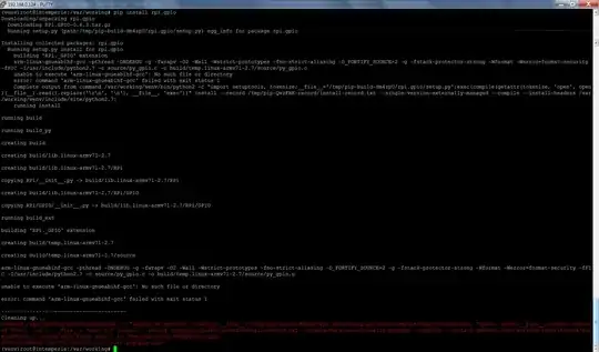

The problem that i'm having at the moment is that when I try pip install rpi-gpio i get the following error:
unable to execute 'arm-linux-gnueabihf-gcc': No such file or directory
error: command 'arm-linux-gnueabihf-gcc' failed with exit status 1
Cleaning up...
Command /var/working/venv/bin/python2 -c "import setuptools, tokenize;__file__='/tmp/pip-build-7BUUIX/rpi.gpio/setup.py';exec(compile(getattr(tokenize, 'open', open)(__file__).read().replace('\r\n', '\n'), __file__, 'exec'))" install --record /tmp/pip-x_nNzV record/install-record.txt --single-version-externally-managed --compile --install-headers /var/working/venv/include/site/python2.7 failed with error code 1 in /tmp/pip-build-7BUUIX/rpi.gpio
Storing debug log for failure in /root/.pip/pip.log
I'm using minibian as the operative system, I have already installed apt-get install python2.7-dev
I'm on a Pi3

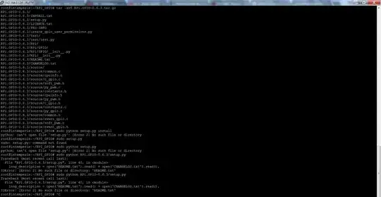

EDIT_02: I tried manual installation of RPi.GPIO and I'm getting an error when I try to run sudo python RPi.GPIO-0.6.3/setup.py
ERROR
    sudo python RPi.GPIO-0.6.3/setup.py Traceback (most recent call last):
File "RPi.GPIO-0.6.3/setup.py", line 40, in <module>
long_description = open('README.txt').read() + open('CHANGELOG.txt').read(), IOError: [Errno 2] No such file or directory: 'README.txt''
It somehow doesn't find the README.txt file but I checked and It was succesfully extracted from the download.

May manual installation work for you. You have to follow steps shown below.
Step-1:Download the library
wget https://pypi.python.org/packages/e2/58/6e1b775606da6439fa3fd1550e7f714ac62aa75e162eed29dbec684ecb3e/RPi.GPIO-0.6.3.tar.gz
step-2: Extract the archive to new directory
tar -xvf RPi.GPIO-0.6.3.tar.gz
Step-3: Browse to the new directory
cd RPi.GPIO-0.6.3
Step-4: Install the library
sudo python3 setup.py install
Step-5: Remove the directory and archive file
cd ~
sudo rm -rf RPi.GPIO-0.*
Note: You should take care about step-2 and step-3. Since I have no idea about the tar.gz file gets downloaded into which directory.

In one of your replies to others, you mentioned you are using minibian.
Originally you have the error
and you tried unsuccessfully to
apt-get install gcc-arm-linux-gnueabihf
but the package could not be located.
Do this after you ssh into your minibian
apt-get update
apt-get install build-essential
then go to wherever your working directory is and start your virtual environment
cd /var/working
. venv/bin/activate
and try again with the rpi.gpio install and it should now work for you, as it did for me.
pip install rpi.gpio
