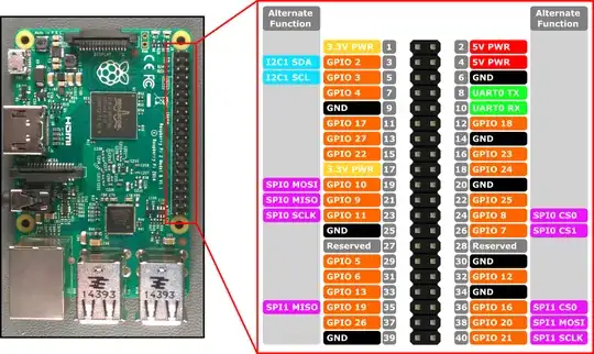

My device is connected to pins 19, 21, 23, 24, 25:
Enter image description here
Does Linux use the same pins for SPI as Windows 10 IoT?

It was a stupid error on my side.
SPI_IOC_MESSAGE ioctl call expects pointer to the first spi_ioc_transfer element in the argument.
I passed a pointer to pointer instead, because I saw many samples passing &array there, and I’ve forgot about this. I’ve fixed my C++ code, and it works now.
Meanwhile, cat /dev/spidev0.0 & command still prints Message too long. Apparently, that’s normal state of things.
