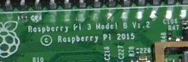

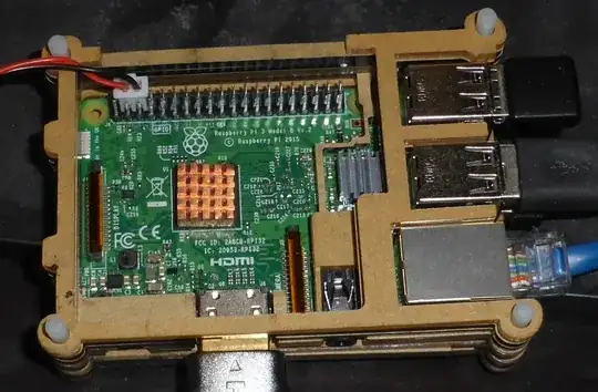

I have an odd question to ask. I'm only new to Raspberry Pi's and recently acquired my first one. However I'm struggling to find the difference(s) between the Raspberry Pi 3 I bought, and the B+ model as shown in a previous answer. From the layout of the board I've got, it looks like (for all intents and purposes) the B+ model. However, on closer inspection on the motherboard, it says 'Raspberry Pi 3 Model B V1.2' .
Raspberry Pi 3 Model B??
Can someone tell me what the difference is? Do I have the B+ version? If not, can someone explain to me what the difference is between the models? Is it something that I should be worried or concerned about?

Regardless, since your Pi specifically says 'Raspberry Pi 3 Model B V1.2', you can be absolutely sure it is, as stated, a Pi 3 Model B.
In fact, the Model B was the only model of Pi 3 available as of late 2017—the Pi 3 Model A hadn't yet been released.

However at the time of the question the 3 B+ didn't exist yet. On the picture you can see that on the PCB it says Raspberry Pi 3 Model B V1.2
B not B+ !!1

The inscription you quote is from a regular model 3B
Also, the chip layout is clearly not a B+

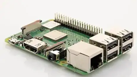

This is the layout of a 3 B+
The 1024 MB (1 GB) variant is now available. The price is $44.95
Element14 Raspberry Pi 3 B+ (Amazon)
