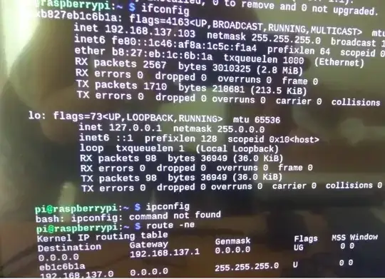

I am trying to get the IP of my Raspberry Pi running Raspbian. I have run the ifconfig command in the terminal and I get this result.
terminal image
Is the first line for iface enxb827 for the ethernet?
How do I turn on the wifi? I have tried many ways, yet I still can't turn it on.

It appears from your question that you already have an Ethernet connection to your network, which should work. It is possible to have both an Ethernet and WiFi connection, although this creates conflicts, and is not recommended; use one or the other until you become familiar with networking.
If your question is what IP is the Pi using; hostname -I on the Pi will show this, and it is also listed in ifconfig.
In Stretch it's no longer eth0, it uses the new way of naming interfaces, predictable interface names.

Follow the simple instructions given here to disable unpredictable stable network names, to get back stable predictable names, so you can identify eth0 and wlan0: https://raspberrypi.stackexchange.com/a/72261/64046.
In short:
sudo ln -s /dev/null /etc/systemd/network/99-default.link
sudo reboot
