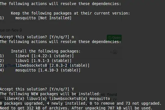

After you followed the instructions to install mosquitto and you get the 'unmet dependencies'error, do the following:
sudo aptitude install mosquitto
After a while you are then presented with some options to solve the issue. First option ("leave as is") chose 'n' then you are presented with an option to install the dependencies. chose "Y"
edwin
