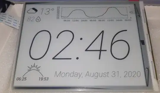

I've used an ePaper Display from Pervasive Displays which has a sub-1-second refresh. This should be more than sufficient for a status display.
I'm using my display to show the time and whereas it does only update once per minute, that's a choice I made as I don't need to see the seconds on my clock.
You would need to convert your web app to an image though as that's what you send to the display.
You can see an (older) example of it working here.
screenshot from youtube
