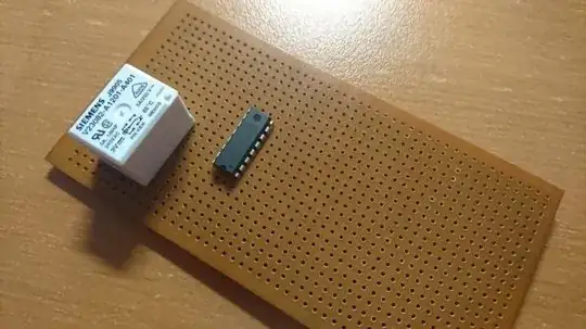

It works but i can't connect relay directly gpio. I have used l293d to control relay and i can connect relay directly l293d. You can use same power adapter for raspberry pi and relay without any problem. Additionally you can use this article to control relays: http://www.reuk.co.uk/wordpress/raspberry-pi/simple-raspberry-pi-relay-control-over-the-internet/
