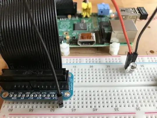

Hardware Setup
I am using a Raspberry Pi P1 2011.12.
The bare Infrared LED connected to GPIO#18 and GND. hardware
