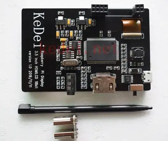

Just a bit of update, I think I should be using USB instead so the question asked was no longer an issue, and did found a monitor that does not hold up the unused slotsKeDei Screen.
