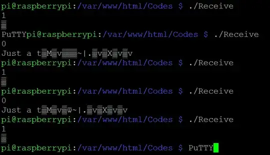

serialDataAvail is suppose to return the number of bytes it has to read BUT it always returns 0. No matter what. The thing is, it still outputs values, as can be seen in the image below: Output from running the code ./Receive is just the name of my C code. I have Transmit and Receive and am only having issues with Receive now.
My Thoughts:
Since it keeps outputting Putty every two tries, I believe maybe the SSH program is somehow effecting the serial communication.
I have searched around to find why the function serialDataAvail() is giving me a 0 when there is clearly something in the buffer but could not find any answers.

I figured out the issue. Posting in hopes that it will help somebody in the future
  1. I flushed the UART system to get rid of the garbage from before.
  2. I needed to add a delay before serialDataAvail(fd); was called to allow the buffer time to receive its characters.
  3. I needed to add a loop to all the code to recheck and see. I probably should have used a for loop to limit the amount of times it checks
  4. I don't know if it was needed per say but it definitely helped I changed the ArduinoMsg variable from a char to a uint8_t
It ended up looking like this:
  serialFlush(fd);
  delay(500);
  while(!(msgLength = serialDataAvail(fd)))
        printf ("%i \n", msgLength);
        delay(500);
  read(fd,ArduinoMsg,msgLength);
  ArduinoMsg[msgLength] = 0;
  printf ("%s",ArduinoMsg);
