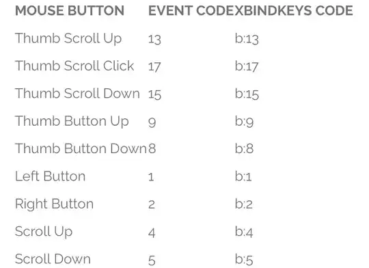

So we need to add our button-to-key configurations, but first we need to know what ‘events’ the mouse buttons are triggering before we can remap them. For this we can use xev, this program is a key and mouse event sniffer. It runs by opening a small window. You can now start pressing keyboard or mouse buttons over the window and see if they are detected. For example the forward button on my Logitech Revolution MX looks something like this:
ButtonRelease event, serial 31, synthetic NO, window 0x3200001,
  root 0x263, subw 0x3200002, time 6377530, (36,35), root:(38,122),
  state 0x10, button 13, same_screen YES
Bellow I’ve included a table for the Logitech MX mouse, these will probably be if you have a newer, or older mouse
This is the table!
