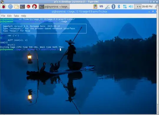

The sage version 6.9 for 12.10 Ubuntu arm available through http://mirrors.mit.edu/sage/linux/arm/meta/sage-6.9-armv7l-Linux-Ubuntu_12.10.tar.gz.torrent works perfectly on Pi 3B board with 32 bit Raspbian Jessie desktop. Just extract that downloaded tar.gz file into RPI's home directory and give executable permission to the binary file "sage" by $ sudo chmod +x sage and then launch the program by $ ./sage in terminal and there it goes, a fully working sage interface.enter image description here
