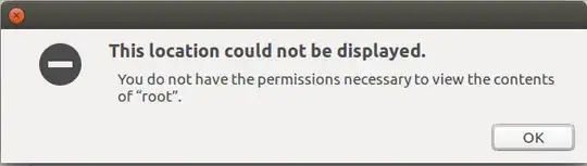

If I access the Pi-SD from Ubuntu I can read all files which belong to pi. But I cannot read the files which belong to root. Can I make all the files of pi similar unreadable to Ubuntu (or any other OS). I would like to keep the file/folder permissions just make it non readable from outside.
And is this difficult to switch off for anybody?
EDIT: I have a paygate in my software and would like to make it harder to be bypassed. I read, that it is basically impossible to secure code if the user has the device but I want to make it more difficult for a default user.
How can I protect software on the Pi for commercial use?
