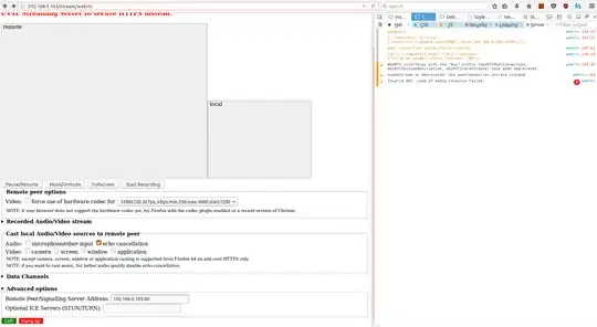

The next thing I try to do is to go to http://192.168.0.103/stream/webrtc and see a WebRTC stream.
When I load the page I see no video, just this page:
When I press Call nothing happens and the server dies - I can no longer see any streams and the web page doesn't load.
