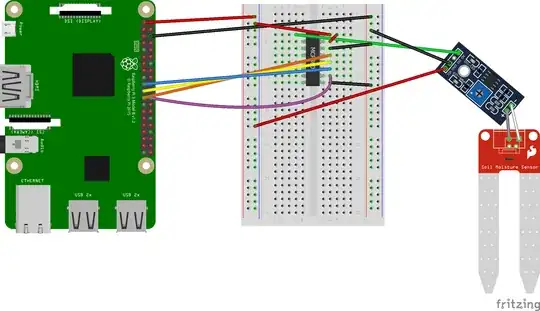

I am using the YL-69 with a MCP3008 and a Raspberry Pi 3:
I am using the sensor for soil moisture measurement (plant monitoring). This is the code which gets analogue sensor values:

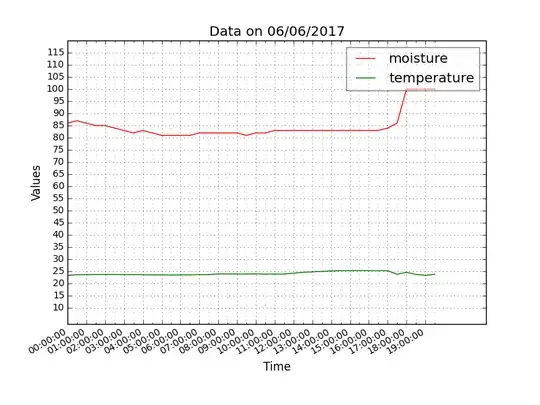

I have been watering the plant for about three weeks. Then I suddenly got values like this although I have not been watering for days:
After further inspection I saw that one of the LEDs on the YL-69 PCB was off. Also one of the pins on the sensor itsef fell off. It looks a lot like corrosion.
