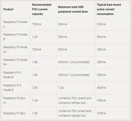

From the Official Raspberry Pi Foundation site:
In terms of minimum voltage I wouldn't go with anything less than 5V.
The maximum GPIO output is around 16mA per individual pin or all pins at ~3mA for a total of around 51mA.
For more details I suggest you give this post and this post a look.
