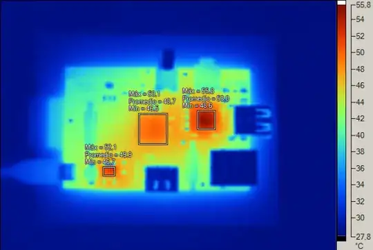

Idle - no Ethernet:
Thermal image at idle
  1. 49.9°C
  2. 48.7°C
  3. 53.0°C

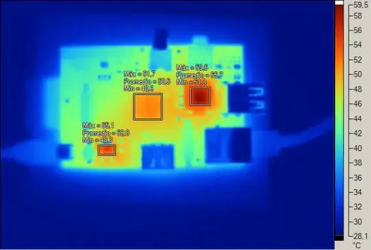

Idle - Ethernet connected:
Thermal image at idle with Ethernet
  1. Ethernet controller temp increases to 55.7°C with a maximum of 59.5°C.

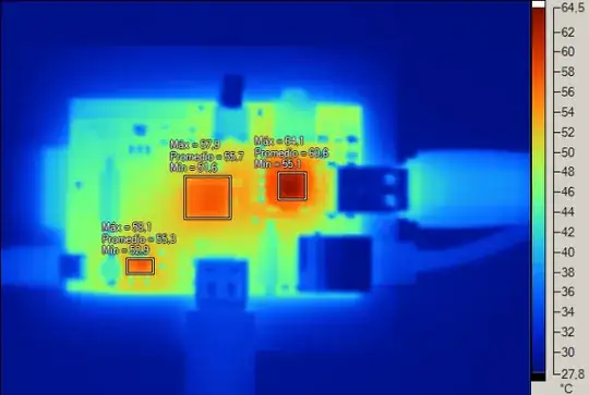

CPU Stress Test:
Thermal image with CPU Stress Test
  1. CPU temp increases to 55.7°C with a maximum of 57.9°C.

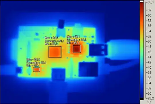

High Definition Video Playback:
Thermal image with HD video playback and Ethernet
  1. CPU/GPU temp increases to 56.1°C with a maximum of 58.6°C.
  2. Ethernet controller temp increases to 60.8°C with a maximum of 65.1°C.
