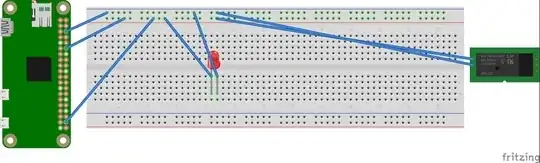

It seems to me that the problem is wiring. You don't show it in this question, but the image in the link you provide is this:
Don't use this:
bad wiring
That's not going to work reliably if it works at all. First, the LED needs to have a current-limiting resistor. A value of 330 ohms should work for most LEDs and give sufficient brightness (around 10mA current).
Second, you are apparently connecting pin 12 (GPIO18) and pin 38 (GPIO20) directly together. This is almost undoubtedly an error.
Use this:
Instead, try this:
Pin 6 (Ground) ----/\/\/-----|<|----- Pin 38 (GPIO20)
                   330 R     LED

Note that the cathode of the LED (shorter leg, also facing flat side of LED) must be connected toward the ground side and the anode (longer leg) toward the GPIO pin.
