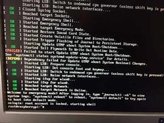

I am working on a raspberry pi project and I am having trouble duplicating the OS image. What I am trying to accomplish is creating an exact bootable copy of the working OS with its files and settings intact. I am running Raspian Lite and I used this video tutorial to create an image of the working OS.
The program created an .img, and it could boot. However, it failed to find the root user directory which made it boot into safe mode. Anyone successful in imaging working copies of Raspbian Lite that could help me out? It would be greatly appreciated.

I have encountered the emergency mode once for a simple mistake in /etc/fstab (default instead of defaults). In emergency mode there is a suggestion to run journalctl -xb to view system logs. In my case after running that command and on the last page of many the error was somthing like ... unknown option 'default' in fstab ....
