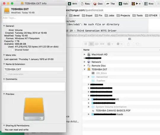

The drive works fine attached to my OSX laptop. It has only one partition. This is the first time I've tried to mount any NTFS USB device on wheezy, so I apologize for any basic mistakes.
