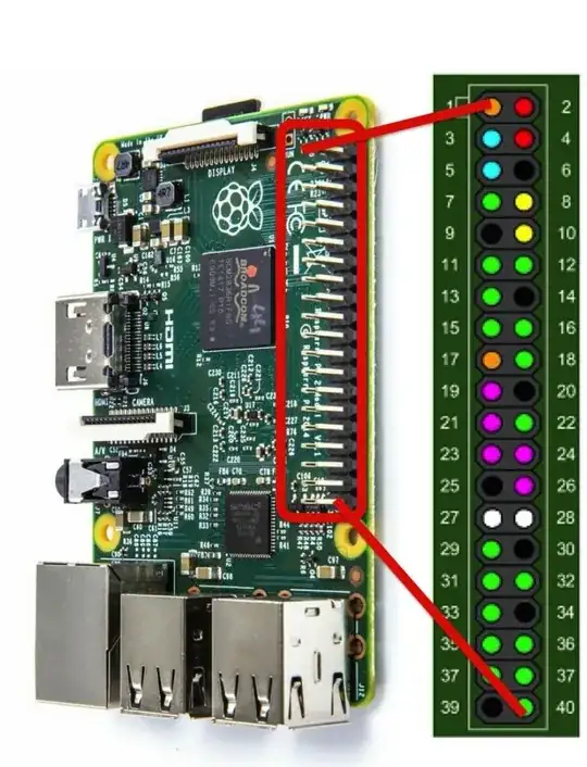

“Physical” column
This is the pin number on the connector. it is simply the physical number which is marked as the following picture. We can easily count its 40 pins without caring the functions.
RaspberryPi GPIO PINs
