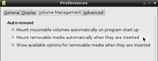

The auto-mounting of USB devices in Raspberry Pi is handled by the GUI/DE (as suggested helpfully by multiple folks here), which is based on LXDE, and specifically, it's controlled by PCManFM, the file manager. To disable this behavior, open the File Manager, and from the Edit menu, choose Preferences. Pick the Volume Management tab/item.
File Manager menuFile Manager Preferences
The second option, "Mount removable media..." can be unchecked to disable auto-mounting "removable" class media on insertion. The "Show available options..." setting can be disabled to prevent the pop-up window prompting for available programs. I'm guessing that the first option, "Mount mountable volumes..." is what is mounting my thumb drive when it's present at boot. The screenshot above is from an older version (wheezy?); Jessie has a few more minor options that aren't relevant to the question, but define the behavior of File Manager when devices are mounted/unmounted.
I didn't find any information about how LXDE/PCManFM classifies a USB device as either "mountable volumes" or "removable media" but for my purposes, I can disable both to simplify developing my own mounting scripts. Thanks to all of the great input here which set me on the right search path to find this. As others stated, this is not unique to Raspberry Pi, but as there are a lot of Pi users who are new to Linux, that may not be obvious.
