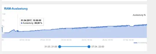

Since I also backup maildir folders (managed by offlineimap) I notice that the mount.ntfs-process is getting slow and eats up a lot of memory. The usage is increasing over several days and sometimes it's falling down very fast. output of picontrol The current outpot of top shows this:
pi@raspberrypi:~ $ top
top - 21:06:15 up 7 days, 23:06,  1 user,  load average: 1.91, 1.50, 0.86
Tasks: 140 total,   1 running, 139 sleeping,   0 stopped,   0 zombie
%Cpu(s):  7.8 us,  6.1 sy,  0.0 ni, 74.4 id, 11.7 wa,  0.0 hi,  0.1 si,  0.0 st
KiB Mem:    996452 total,   968956 used,    27496 free,   419484 buffers
KiB Swap:   102396 total,    79640 used,    22756 free.    44644 cached Mem
  PID USER      PR  NI    VIRT    RES    SHR S  %CPU %MEM     TIME+ COMMAND
 1313 root      20   0  422904 419996   1408 D  50.9 42.1 992:38.16 mount.ntfs
 1094 root      20   0       0      0      0 D   1.3  0.0  37:07.14 usb-storage
