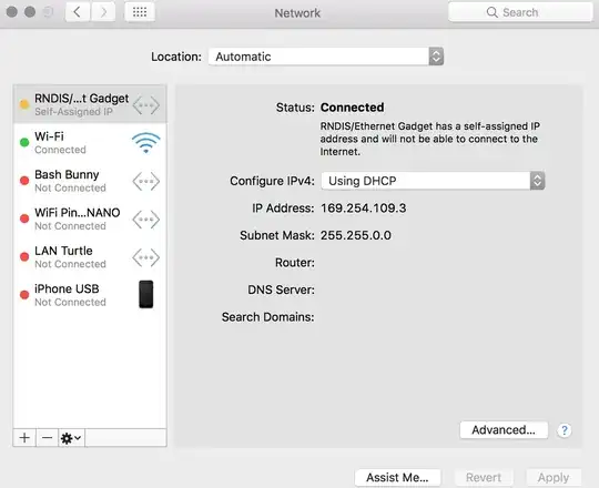

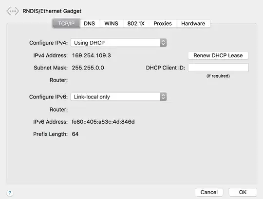

  5. Configure the RNDIS/Ethernet Gadget exactly as shown:
https://gyazo.com/f75f56e667b25a8708c3d4bbb03ff684

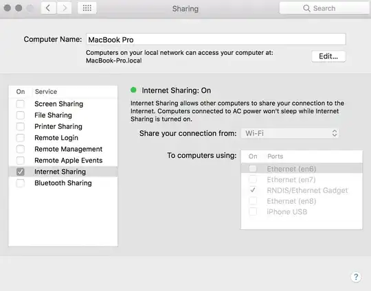

  1. Turn on Internet Connection Sharing (ICS):
https://gyazo.com/697e4cafca6e77c17e6e382aa284f328

  2. Wait for the Pi to boot up. If you see the Pi0 obtain a Self-Assigned IP with an Amber light, don't fret, according to Re4son: "I don’t know why Apple decided to go with an amber light instead of green but amber seems to mean “All ok, this MacBook assigned an IP address to your pi, you are ready to rock’n’roll””:
https://gyazo.com/b9037ca3330c8ef60e6f406e3a4a33bd

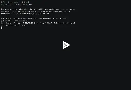

  1. ssh into kali-pi.local if using Re4son's Kali Kernel: ssh root@kali-pi.local
  2. Run ifconfig usb0 to see if the Pi0 has obtained a valid IPv4 address. If the Pi0 did not obtain a valid IPv4 address then run: ifdown usb0 && ifup usb0.
asciicast

First, you need to have an RNDIS/Ethernet Gadget interface in the Mac's Network Preferences.
This is available as standard on Sierra. However, it might not appear automatically in the Network Preferences, and you may have to add it, using the + icon. The list of available interfaces to add will not include RNDIS/Ethernet Gadget unless the Pi Zero is actually attached.
Once added, you should see that it's Connected, and that
RNDIS/Ethernet Gadget has a self-assigned IP address and will not be able to connect to the Internet.
You should now be able to reach it at raspberry.local, e.g. with ssh pi@raspberrypi.local.
The next step is to give the Pi Internet access; you can do this in Sharing Preferences, and share the Internet connection to the newly-established interface.

On your Mac, you need to enable network sharing under the System Preferences / Sharing option. You should then be able to see hostname.local (if your distro supports avahi) or a useful IP address for the local/remote side with ifconfig.
