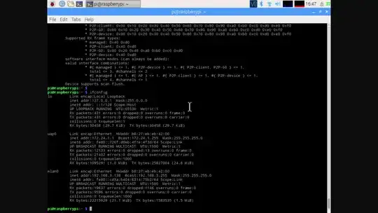

It is perfectly possible, my Pi Zero W does so, but the client and AP must use the same channel.
See a screenshot from my ZW:
The output from your iw list shows that only the second combination allows managed (i.e. client) and AP at the same time , but it says channels <=1. That is, they need to use the same channnel.
I have used the guide from http://imti.co/post/145442415333/raspberry-pi-3-wifi-station-ap (which is the same linked by Alfredo Pons Menargues) adapted to my own needs.
