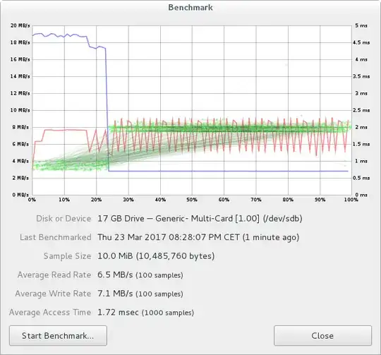

The card is brand new (I did format it completly using gnome-disks to all zeros), I find it hard to believe it is dying. Is there a way for sure to test the card from another linux laptop if this is the case ?
Here is what I did (following info from here), which gave me:
It is labeled Kingston 16GB class 10 Micro SDHC. Since I did not see anything wrong in the dmesg log from my laptop, I would think the SD card is in good shape.
Running some additional tests (from here), leads to:

Well it looks like this is simply just a fake SDcard (cheap from ebay). Using some low level utils on Linux here is what I get:
