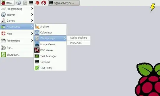

I have a Raspberry Pi 3 Model B and it seems like it's always low on power. You can see this by the lightning bolt on the top right corner.
I started out by plugging the USB power into a 1A iPhone charger. It worked but the lightning bolt was always there. Then I tried a 2.1A port and the lightning bolt was still there for a majority of the time (any time I clicked or while the Pi was opening an application, while idle it would go away)
I guess I have two questions:
  1. What is the minimum power a Raspberry Pi needs to completely remove the low-power indicator?
  2. What type of issues will you run into if they Pi has low power for an extended amount of time?

First off the raspberry Pi corporation has not realeased a model "3+" so assuming that you are using a model "3" the power requirements from the official FAQ located Here state that 2.5 amps is the recommended USB power supply current capacity. Which is higher than the 2.1 amp supply that you have which means that you should likely upgrade to a power supply capable of delivering a higher amount of current. Also I would personally recommend that you stay away from off brand power supplies as they aren't usually designed to operate 24/7 and are usually unreliable. Furthermore to answer your second question if your Pi has low power for an extended amount of time you may face unexpected shutdowns which can corrupt your SD card. If you wish to remove the low power warning without changing your set up you could also try lowering the clock speed of the Pi, google "disabling turbo mode on the Pi"

It depends. The Raspberry Pi 3 can use anywhere from 230mA when idle, to 350mA when using the camera, to 720mA when using all 4 cores of its CPU and that is not counting any additional draw from USB devices.
So to quote RaspiTV: "It’s important to understand that the 2.5A is specified to work in pretty much all circumstances you can think of. But in many cases, a bit less will be OK, depending on what you’ve got plugged into your Pi."
If you are interested to learn more, here is a great analysis from RaspiTV.
