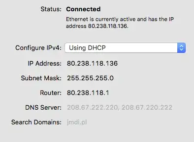

The same cable when connected with my Mac works perfectly but when connected to my Raspberry Pi 3 model b i can't connect to internet. This is the new output of the ifconfig:

And this is view from my Mac
