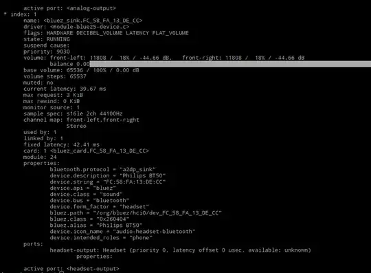

I can't get any audio from mpc. I can listen to sounds from websites.
Screenshot from my Console
I think I might need to edit the etc/mpd.conf
This might help as well: enter image description here
