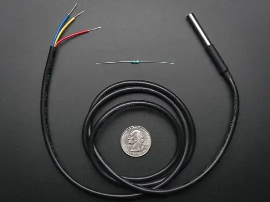

That's the main problem with the Enviro pHAT, and the SenseHAT for that matter - proximity to the Pi affecting results.
You're better off getting a Dallas 1-wire temperature sensor, preferably one with a long cable (such as, and this is just an example, the one contained in CamJam EduKit 2), or extend one without a lead by using jumper cables. This will let you get the sensor away from the Pi.
You can then use the 1-wire protocol to read the temperature. Instructions for how to do that can be found in this worksheet.
If you really don't want to extend the temperature sensor away from the Pi, it may be possible to compensate for the effect of the CPU. This post on yaab-arduino.blogspot.co.uk outlines an attempt at this in Python, using a moving average of the readings from both the temperature and pressure sensors (the pressure sensor can also measure temperature):
