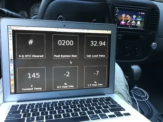

I was finally able to make this work. Had to make a virtual serial port ttyUSB0 with socat on raspbian stretch.
socat pty,link=/dev/ttyUSB0,waitslave tcp:192.168.0.10:35000&
Then I followed these instructions
http://www.cowfishstudios.com/blog/obd-pi-raspberry-pi-displaying-car-diagnostics-obd-ii-data-on-an-aftermarket-head-unit
python obd_gui.py
Output shown is my VNC screen to raspberry pi 3
python obd_gui
