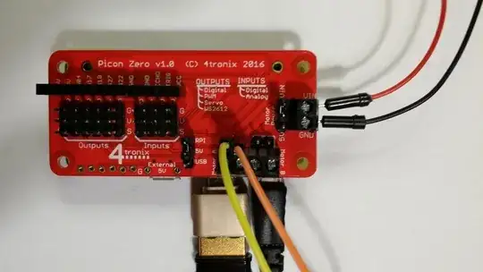

Picon zero setup
  • Picon zero set to external power supply:
  • motor power jumper set to VIN
  • 5V jumper set to RPI (not relevant according to picon zero papers)
  • external power supplied by LEGO® Power Functions AAA Batteriebox (88000) with 6x1.2V AAA batteries)
  • Lego Batteriebox outgoing line 1 (?V/+) connects to VIN, and GND/0V/-
    connects to GND
Motor setup on picon zero
motor A) pins: LEGO® Power Functions M-Motor (8883) No other pins are connected.

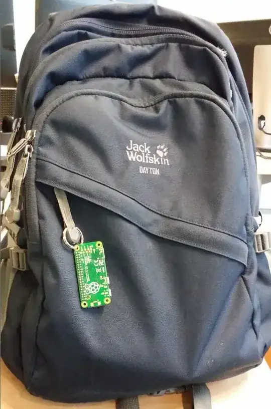

no green LED, Wifi dongle doesn't light up, no network connection. I assume it's bricked. Edit: Yes, it is definitely bricked. A Raspberry Pi Zero doesn't come with a polyfuse, so there is no overnight healing to be expected and in my case it didn't happen either. I connected it to a power supply two days later and it didn't sprang to life just got very hot. I am using it as "wearable" now, sort of ;-)
bricked raspi zero still wearable

Photos: The whole setup, only 2 of the Lego lines are used. Closer view on the picon board

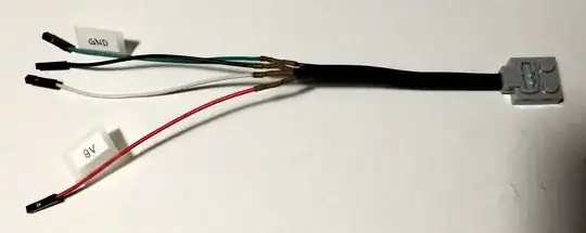

First the cable-"hack". I just used some jumper wires. The Lego connector is layed out as follows, from left to right see photo: ground, groundless positive, groundless negative, 9V.
lego cable layout, no copyright
cable hack
Color coding
  • GND: green
  • GND-less positive: black
  • GND-less negative: white (pos and neg can switch for direction changes)
  • 9V: red

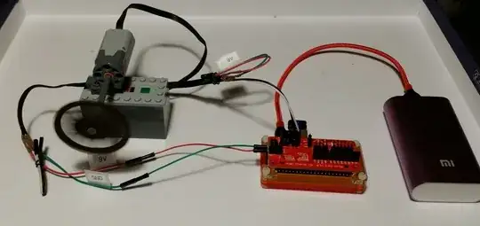

Here is the working setup: You see
  • a LEGO® Power Functions AAA Batteriebox (88000) with 6x1.2V AAA batteries), connected with GND and 9V to the external power of picon zero
  • a Lego motor, connected to Motor A with the two ground-less middle cables whith changing polarity, here black and white. enter image description here
The pi is powered by the powerbank, and controlled over ssh via Wifi and DynDNS.
