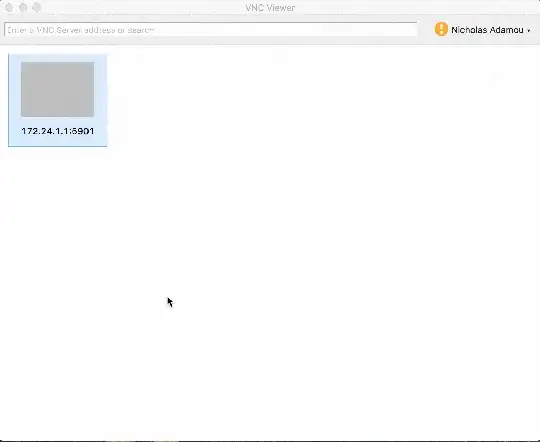

Then I attempt to connect to my VNC server as seen below:
VNC Connection Attempt
BAM grey screen! Why?!
