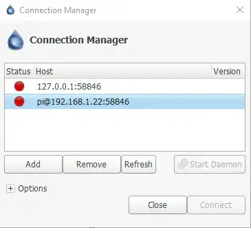

Now, Deluged is running fine and all except when it doesn't. It constantly disconnects at completely random intervals. Sometimes deluged just crashes, so I setup a cron job to constantly check if it's dead every 2 minutes, as some people suggested. Well, Deluged is also giving me extremely variable speeds that seem to start out high at near max bandwidth (I have 6 MB/s) and then dip to practically 0. This is usually about the time that the above problem occurs, or when Deluged freezes for 5 minutes (not updating speed). The problem is that although sometimes only Deluge dies, sometimes my Pi just completely refuses control at all (rarely happens though). SSH stops working, frozen at random points of the connection process, VNC doesn't ever auth/connect, my Plex server dies, Filezilla stops connecting, and as already mentioned, Deluge on W10 disconnects from the Pi connection, appearing offline:
Pi Offline as seem from Deluge
The Pi itself seems perfectly fine with low resource usage in the Task Manager. After I do manage to re-control the pi by physically rebooting it at it's location (I hate doing this as it is headless in an awkward location to plug a mouse/keyboard to) and restart the deluge manually form the command line in SSH, everything works all right until either this or Deluge crashes again. The strange part is although I followed the above tutorial exactly, it doesn't seem to relaunch Deluge correctly upon start up, forcing my to manually kill it with
