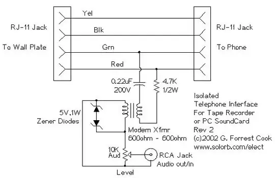

Audio input/output. This is relatively easy and a circuit such as this provides the information you need. From memory audio is about 1.2 V RMS on the line. This phone tap schematic was used to allow a tape recorder to either record, or play music to the line depending on which connector (Mic or output was used).It's not a great circuit as you have to position the pot carefully at the high end to get enough signal output to the line. Notice however the back to back zeners to clip the ring tone voltage!!

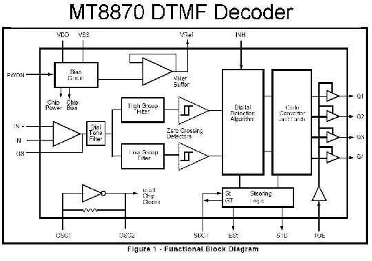

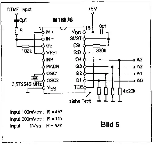

If your telephone has DTMF dialling (dual tone multi frequency) then you'll need to interface the RPi with a DTMF decoder chip like this one: -
You'll also need to send a DC loop current to power the phone. Somet5hing like 25 mA with an open circuit voltage of 12 volts will power most phones quite easily but don't try and supply a hard 12V dc to the phone because you might get smokde. Maybe 12V through a 220 ohm resistor. The phone should power at this level and you will be able to wire the DTMF decoder to the line via a capacitor and resistor arrangement something like this: -
