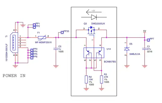

In the right top corner of the connected lcd screen, there is a small yellow thunder icon constantly. What does it stand for and more importantly, how to turn it off? I have connected a 5V, 4A power adapter to the board. When measuring voltage on the adapter, it 5.16V. On the Raspberry Pi gpio header however, the voltage is only 4.5V. Voltage drop of that amount (0.5V) is impossible to be caused by the micro usb cable resistance. There is a little circuit that protects agains usb backcurrents and it definetly adds some voltage drop, but it should be around 0.1-0.2V:

Connect to an adequate supply! Full stop! If it lights the voltage is too low (< 4.63±0.07V). See Raspberry Pi Power Limitations which will explain all.
This is not the place to go into the subtleties of measurement, but there are many sources of error, depending on HOW you measured, and what tool you used.
Definitely untrue - there are some really bad cables out there!
