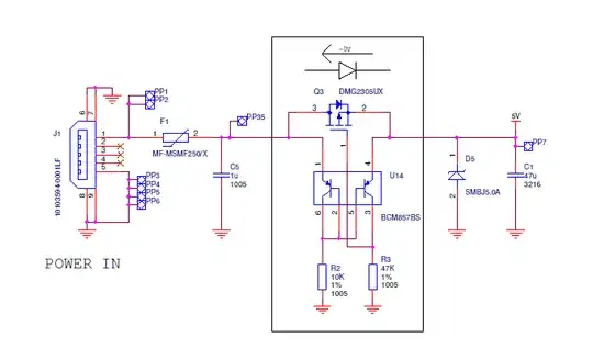

Unlike RPi Zero, RPi 3 doesn't have a USB On-The-Go port. The micro USB connector on RPi 3 can only be used as power plug, as the data lines are simply not connected:
